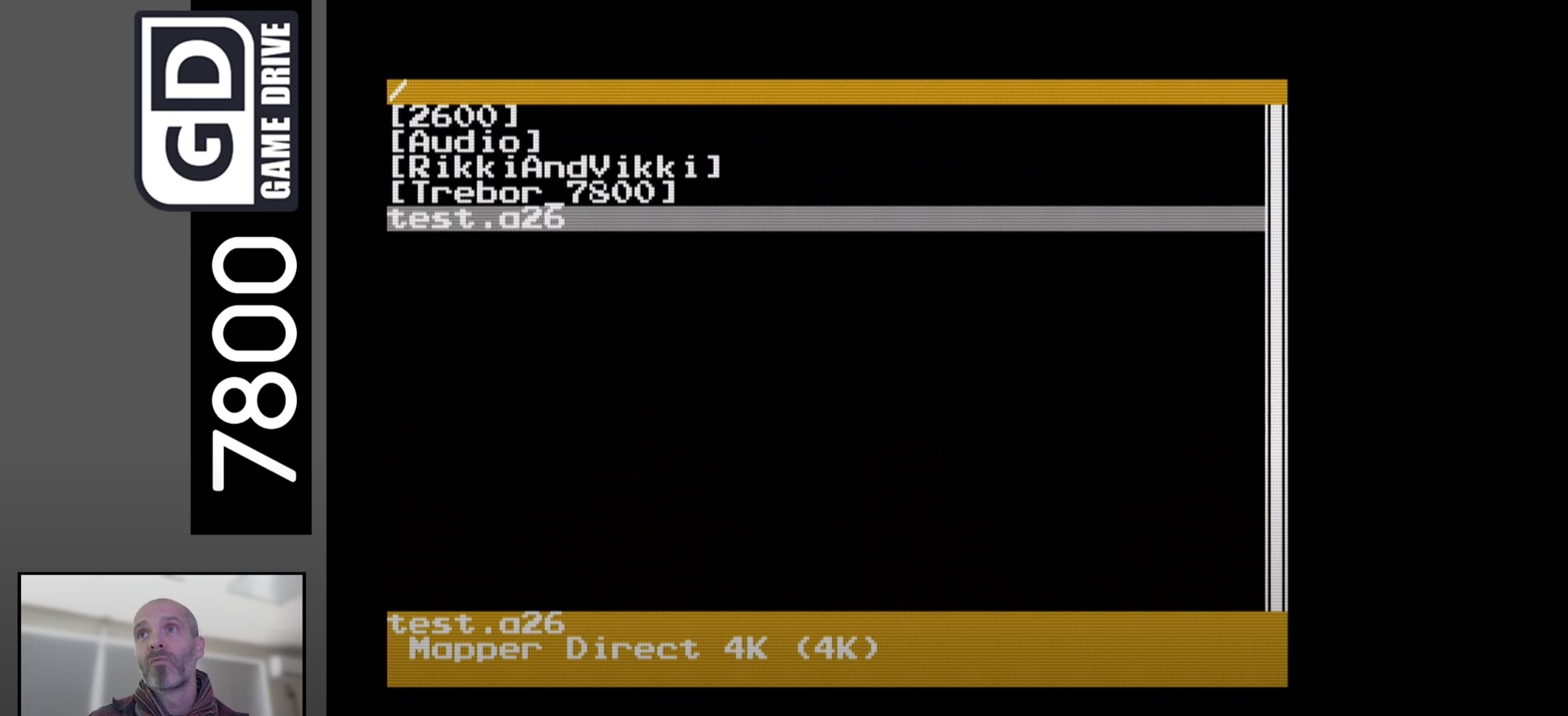

https://www.youtube.com/watch?v=xGKEnCuZdBM
A first look at the 7800 GameDrive cartridge, a way to play your old Atari 7800 (and 2600) games from a memory card on your 7800. Support for all commercial game mappers for 2600 and 7800 as well as RGB and stereo audio out via MegaDrive 2 style mini-din on the cartridge itself. Audio support includes DUAL POKEY, YM2151 and TIA.
